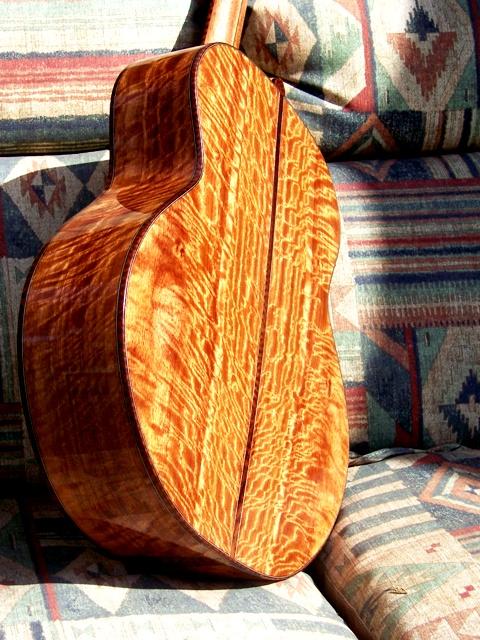

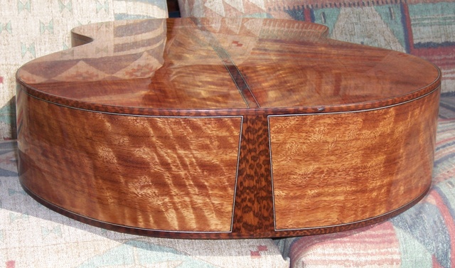

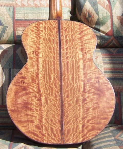

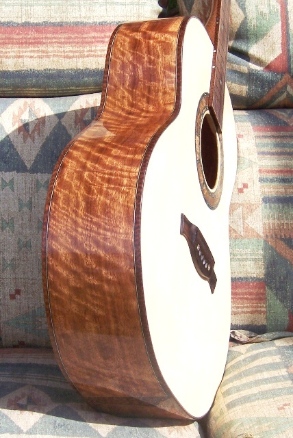

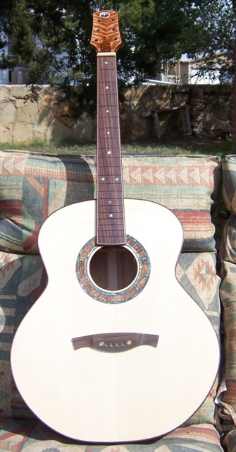

Buffed out the finish Sat. Will fret tonight. Should packup and go in a week ot two.
Yes there will be an end pin MichaelP38992.360474537

That curly narra is gorgeous Michael and what a great guitar as usual.The snakewood really looks good with the narra too.Your rosette is awesome! Another Beauty from MP. Is your bridge and Fretboard BRW ?They look great too!
PostPosted: Mon Oct 02, 2006 12:00 am
Na! it is EIRW

Lovely guitar and wood combination. The narra looks very different in terms of coluor in each photo. Does it look different in different lights and reflections, or which of the photos is most like real life. Personally I love the way it looks in the last picture you have posted.

Yes!!! This stuff is like flashing neon lights under finish the end graft shot is the color in flat light but like you said it looks a bit different from each angle you look at it. it really drives my auto color balance on my camera nuts MichaelP38992.395462963

Beautiful, Michael! That rosette is just fantastic. I think you've taken Zoot to a new level! Congratulations!!!

Some one get a hose and help me put out this fire
Sorry for the repost of this picture, but I just had to say it Every time I see this box at this angle I think of the movie back draft

michael, it looks amazing. well done. in dreaming of my future builds i thought that flamed back and sides with flamed bindings would look too busy. your guitar proves that's not the case. nothing but beauty.
and your right about needing help with the hose. that back is stunning.

Is that the OLF SJ shape, or - ?

It is the same shape as the OLF SJ. But since the OLF came about by me donating a version of my plans to the forum, I will say this one is my SJ shape But Even Ameritage wont call my custom cases MP SJ it is the AME-32OLF Not a biggie though. As long as the fit

It works great. Like any high figure curly wood bending tight bend is a issue. the curl want to separate in tight bends. On this set I had a little separation on the inside of the upper bout. I fixed it with CA using a rounded caul, cam clamps and some non stick tape. Actually the outer cover for double sided tape carpet tape it is like a thin sheet of teflon. This kept the Ca from sticking to the clamping caul. Outside of the figure separating in tight bend the stuff works like koa. In fact it taps a lot like Koa just a bit brighter.
It smells sweet. It does make me sneeze when sanding. It sands easy, does have moderate pores, but it is pretty scatch resistant. Glues very well. no noticable oils. is not bad about color transfer.
